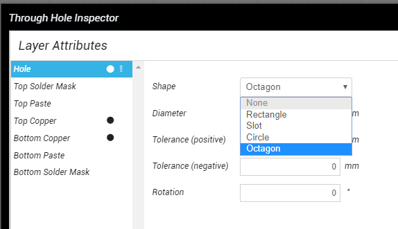

         You can use octagonal PTHs
Hi nalivaiko,
When making the PTH, it shows that the hole is an octagon and the plate is a circle. I want it to be the other way.
Oh, I see. This functionality is not currently supported.
